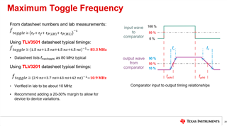

  • Hi Luciano,
    It doesn't seem like the LMV7219 has a maximum toggle frequency on the datasheet.
    The way we estimate the toggle frequency is using this equation:
    Please note that the resulting value from this estimate is not guaranteed by the datasheet and that you should add a margin of 20% to 30% to allow for device to device variations.
