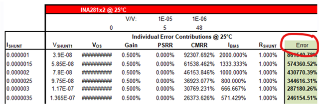

Hi team,
Could you share how to understand the equation in calculator?
Josh
Hi team,
Josh

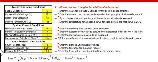

Hello Josh,
The equation used in this calculator is in the under the system input part of the excel file. And this video covers the different errors in case you need to investigate further. https://www.ti.com/video/6096849204001
