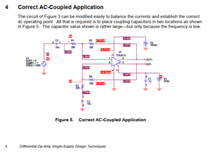

    I thinking about using THS6222 (or 6232) as diferential driver for output transformer (Coilcraft PWB1010LC).
    (https://www.coilcraft.com/en-us/products/transformers/wideband-rf-transformers/smt/pwb/pwb1010/)
    My goal is transmitting CVBS (NTSC) with CAT6 (6A) twisted pair (100 Ohm) at least 100 meters. 200 meters OK also Slight smile
    My source signal is single-ended. And I need your advice what is the best way to convert single-ended to to diff. for THS6222 diff. inputs.
    What OpAmp can best fit? Single supply is highly preferred.
    Also I need also "solution" (with tranformer input and SE output) for remote side. Probably not only OpAmp/line receiver, but also video restorer\equalizer....

    I think I can drive THS6222 (THS6232) directly from single-ended source according SLOA072.
    Simply connecting D2IN+ with capacitor to ground.

  • Hello Alec,
    Bellow a table that I composed browsing and searching TI for video related amplifiers/line drivers
    Most interest chips highlighted green. Could you help me with manage cable capacitance, please.
    See OD (output drive) in table, please. What part is best for 100 m. CAT5/6 cable with ~6 nF capacitance? OPA2674/2677?

  • Hello Alec,
    Thank you for the answer.
    On picture below my line driver (OPA2674) schematic "as is" at current moment.
    The same isolation transformer will be used on receiver`s input side.
    But I would like to use something with "cable equalisation" on receiver input
    if this really have matter. Then (after "diff. receiver-equalizer" ) I can use OPA693 as buffer for driving two load - onboard ADV7850 and
    cable for external video equipment (TV, Video-recorder, etc.)
