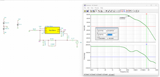

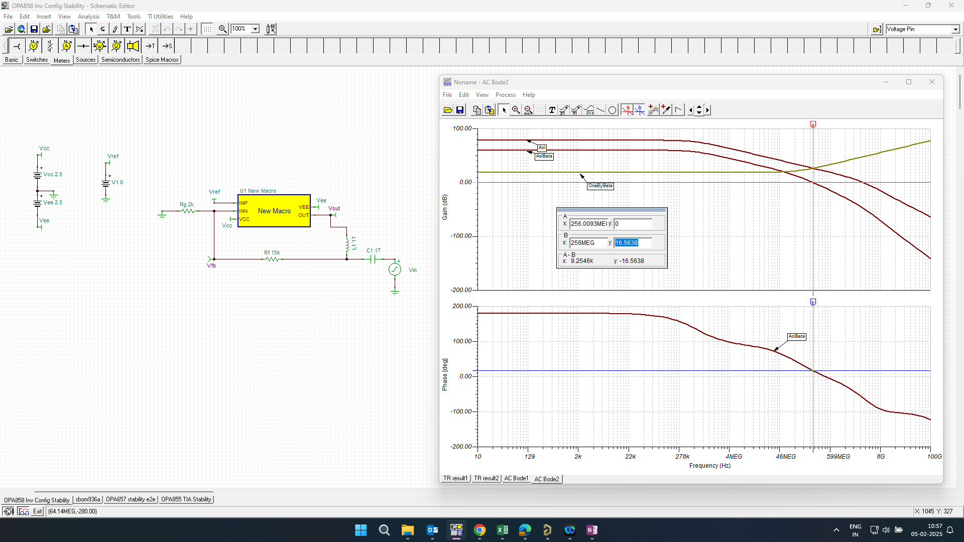

  • Hi Deepthi,
    I checked the stability of you circuit on TINA TI simulation software, and the circuit looks to be unstable without feedback capacitor and Rf=15k, Rg=2k (As per your LTSpice schematic).
    As you can see above, the phase margin of the circuit is only 16.5 degrees, whereas 45 degrees is needed for minimum stability. But I have used +/- 2.5V as supply and not 5V, 0V.
    With 5 and 0V I am getting such irregular response-
    I am not exactly sure why this behavior is happening, probably the DC bias point is not set properly, let me get back to you on this.
    Few points from my side:
    1. Which EVM board are you using? If not TI's EVM, please verify from datasheet that you have adequate decoupling capacitors close to OpAmp's power pins, and follow other layout guidelines too.
    2. Please try once with split supply +/- 2.5V and use Cf of at least 0.5pF. You can ground the non-inverting input.
    3. What probe are you using for measurement? What is the probe capacitance?
    4. Even if oscillations still persist, you can add a series R isolation of 50Ω and check again.
    Aditya

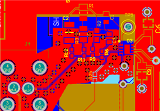

  • Thanks for the reply ,

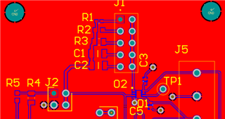

    1.I am using the OPA858-Q1 in a transimpedance amplifier (TIA) configuration on my custom PCB. I have followed all the PCB layout guidelines from the datasheet, including Decoupling: Used 0.1 µF capacitors at the power supply input. TIA Configuration: Included a feedback resistor and a feedback capacitor. Grounding: The non-inverting terminal is directly connected to ground. I am not using the EVM board; this is my own design. Attached is the layout image for reference.
    and i tested on one more board with only this opamp again made small board particularly for this opamp there also i am facing same issue , attached the layout of small board
    2.I am using the OPA858-Q1 in a TIA configuration on a custom PCB with 0.2 pF feedback capacitance and proper decoupling, but my output oscillates regardless of input, even with a split supply.
    3.Keysight N2843A ,500MHz 10Mohm,11pF 10:1 300V RMS LATI.
    4. 50Ω isolation resistor i place and tried, but the output still oscillates; even changing the resistor to 1kΩ results in oscillations at a specific frequency.
    can you please help me in this ,why i am getting osillating behaviour and in dc also i am not able to observe rightvalues at output.

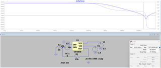

    and one more doubt is , in ltspice i am getting this ac response
  • Hi Deepthi,
    It looks like this issue may be related to the overall PCB design rather than specific component values. For high-speed applications, it’s crucial to follow proper layout guidelines, including short feedback traces, good bypass/decoupling, and appropriate GND/ power plane cut-outs for multilayer boards. I’d recommend reviewing the High-Speed Amplifiers PCB Layout Guidelines for best practices.
    Let me know if you have any further questions.
    Aditya

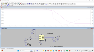

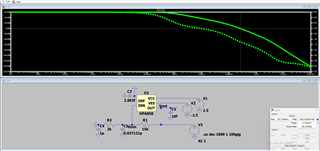

  •  thanks for the reply
    I will go through the above guidelines ,
    but why the pspice is giving such strange results when you just change supply inputs , why the normal circuit with inverting configuration as you mentioned in previous reply  simulation , is unstable Phase margin is less, same circuit in LT spice is giving good result(81degree phase margin) . why ?
    opamp in inverting configuration is it unstable?
    I ran stability simulations for the OPA858-Q1 in both PSpice and LTspice, but the results are inconsistent—phase margins are different, and the PSpice results seem strange. Could this indicate instability of opamp , or is there a reason for these discrepancies between simulators?
    can you please help me out .
  • Hey Deepthi,
    Will look into it and get back to you by tomorrow.
    Aditya
  • okay , thank you sir, looking back for your reply.
  • Hey,
    From where did you get the LTSpice model for OPA858? Can you please share your PSpice and LTSpice simulation files if possible.
    Many SPICE tools use different internal models for the same device. For example, LTspice’s model for the OPA858-Q1 may be a more detailed or updated representation (or even provided directly by TI) than the one you’re using in PSpice. These differences can affect how internal compensation, parasitics, and frequency-dependent behaviors (like phase lag) are handled. As a result, LTspice might predict a healthy phase margin (e.g., 81°) while PSpice’s model—if it has, say, extra phase shifts built into its representation—can show a reduced phase margin.
    Regarding the rail issue, some models are more sensitive to the way supply rails are referenced or how rail-related parasitics are handled. It’s possible that the PSpice opamp model is more sensitive to these supply conditions, which could artificially lower the phase margin in the simulation. In contrast, LTspice might have a built-in assumption or a more robust handling of supply rails that avoids this issue.
    An opamp in an inverting configuration (when properly designed) is not inherently unstable. The differences you’re seeing are more likely due to differences in the simulation models, numerical methods, and default settings between PSpice and LTspice rather than an intrinsic problem with the OPA858-Q1.

  • OPA858 OPAMP with simple inverting configuration with gain 7.5V/V and all PCB parasitic capacitances at the inverting input, non-inverting input, and output  are included. while simulating this circuit in LTspice and Pspice  i am getting phase margin of 14degrees , so its unstable right? how to make this system stable.
  • Hi Deepthi,
    To make the system stable you can try:
    • Add a feedback capacitor of 0.5-1 pF across R1, which will compensate for the cap at inverting input due to OpAmp and PCB parasitics. You can reduce the feedback cap if the system is still unstable.
    • Add an isolation resistor (Riso) at the output, in series with C2. Usually a load cap of 10fF should not make the OpAmp unstable, but you add an Riso of 10-50Ω if the first fix doesn't work.
    • Some resources on how to stabilize OpAmp circuits:

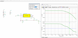

    • I simulated the same circuit in TINA TI, and I got a phase margin of ~16 degrees. After adding a Cf of 0.8pF, the circuit has a phase margin of ~45 degrees, and is stable. I have attached the screenshots and TINA schematic below for reference.
    •  without Cf
    •  with Cf added
    OPA858 Inv Config Stability.TSC
    Aditya Gosavi

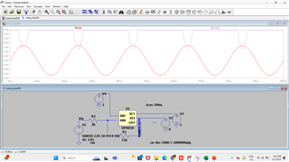

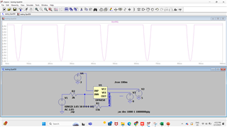

  • Op-Amp Circuit: DC Offset at Output Causing Saturation Issue
    Hi everyone,
    after doing all this stabiiity analysis in opamp also ,I'm facing an issue with my op-amp circuit where a DC offset at the output is limiting the available swing and causing saturation when I increase the input amplitude.
    Circuit Details:
    • Input Signal: Sine wave of some frequency
    • Feedback Resistor (RfR_fRf​): 1.5MΩ
    • Input Resistor (RinR_{in}Rin​): 100kΩ
    • Parallel Feedback Capacitor: Added for stability
    • DC at Inverting Input: 40mV
    • DC at Output: 1.22V
    Issue:
    I am getting an amplified sine wave at the output with the same frequency as the input, but the DC offset at the output is limiting the swing. When I try to increase the input amplitude, the output saturates instead of providing the expected gain. so why am i getting dc offset at input , which is eventually amplifying and giving dc offset at output , which saturates the sine curve  in oscilloscope .
  •   so yellow color graph is input which i gave from function generator , green color graph is the output of teh opamp where the sc is 1.36 .. and please ignore blue color graph , and the circuit  layout diagram is attached
    can you please help me with this.
