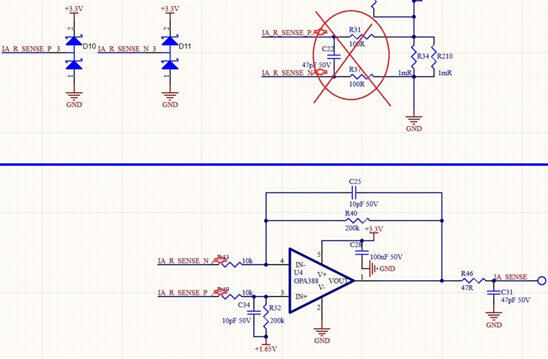

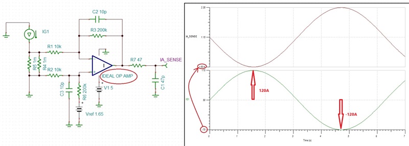

I would like to measure 120 amperes on the shunt resistor with OPA388. When I check the op amp graph, I see non symmetrical current graphs like below. I attached the graph and schematic.
