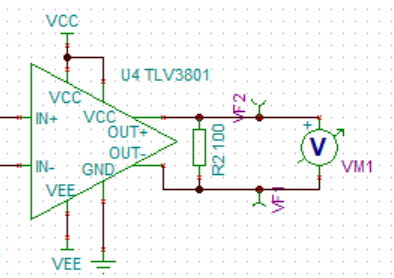

  • Hi Siu,
    Here's a very simplified block diagram of what I'm trying to achieve with TLV3801 comparator.
    This configuration with a split power supply means I can compare the signal with 0V (ground) that devoid of any additional need for power supply and also ground would be more stable voltage reference.

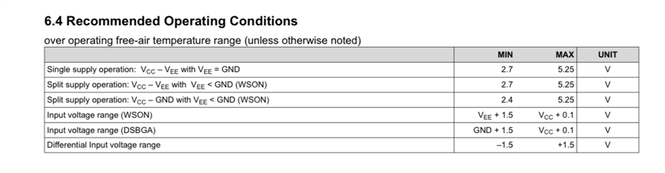

    Thanks for the reply. I also wanted to point out that the TINA spice macro of TLV3801 doesn't not work with any split voltage values less than +/-2.5V contradicting the datasheet min and max values (Vcc- Vee). I tried with +/-2V which is what I need in the system and the macro always shows pV of output. Could you confirm it's a macro issue and I haven't missed anything from my side? I used the TINA design reference file from product website from TI.
  • You’re very welcome Shine and thanks for your persistence and patience
    From the recommended operating conditions, VCC with respect to ground must be greater than 2.4V. So +/-2v is not allowed. If you can increase VCC to 2.5v, it’s ok to leave VEE at -2v
  • Hi Chuck,
    Thanks for the confirmation for single power supply. I was mentioning about the split power supply, shouldn't it ideally work with +/-2V for Vcc and Vee respectively meaning Vcc-Vee = 2V-(-2V) = +4V > 2.7V. But the TINA macro doesn't allow it, could you look into it.
  • Please read the table I inserted. VCC with respect to GND. You’re only looking at VCC- VEE
  • Hi Chuck,
    Yes, I was mentioning about a different use case where I need "split power supply" using TLV3801. I was confirming that when using TLV3801, and I need split power supply operation, I could use Vcc = +2V and Vee = -2V? The table you have inserted says it's possible as Vcc - Vee = 4V > 2.7V (the second row in the table). The TINA macro from TI only works with +2.5V and -2.5V even in split power supply configuration, could you confirm this?
  • Hi Shine,
    I'll need some time to take a look at the internals of the model. Please give me some time to confirm the issue and investigate. I'll reply to this post when I have updates.
  • Hi Shine,
    Even with split supply operation, you need to satisfy TWO conditions:
    First, VCC - VEE > 2.7V. You have VCC = 2V and VEE = -2V, so VCC - VEE = 4V. You are satisfying the first condition, so you are fine here.
    As Chuck was saying, there is a second condition you need to satisfy: VCC - GND > 2.4V. You have VCC = 2V and GND = 0V, so VCC - GND = 2V. This is the condition that is not satisfied, which is why the model is not having a full swing to indicate this error.
