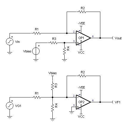

i need help designing an inverting op amp circuit that adds a bias to a signal as well as a gain. This seems to be very simple but for some reason i am having trouble bread boarding it up. Thanks

Take a look at this schematic and transfer function:
I would also recommend this resource: "Op Amps for Everyone - Design Reference"
Chris
Thanks for the circuit Chris, but I'm looking for something where the gain is not applied to the Vbias if possible
Kyle,
Look through the "Op Amps for Everyone" resource for more circuit ideas.
I would recommend the following topologies as good alternatives:
Chris

i guess i should give you a better overall picture of what we are trying to do. We need to convert Diff to SE, then highpass filter (possibly with selectable freq points), selectable gain, and a bias for ADC interfacing. Our current design does all of these functions by using an INA, some tlv2381s, and a couple analog switches. The device draws 0.22mA at rest but increases to 1.5mA when a signal large enough to fill ADC input range is produced. This is a problem because our design constraints say that the circuit can't draw more than 0.3mA at any time other than start up. Any ideas? We are using a TLV2381 to do the Diff to SE conversion right now but are trying to find ways to reduce the IC count and use of our negative supply rail where possible to achieve the remaining steps needed.
