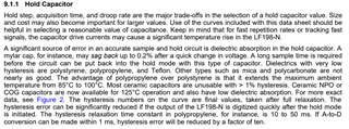

    Your assumptions to go with a polypropylene capacitor is smart. Testing was done on this device with different types of capacitors against it's sample time to see what the absorption error would be. You can see screenshots of the tests from the datasheet below:
    The problem is these tests don't specify the exact capacitors used, just the type of capacitors. That makes it difficult to understand what the effects would be across different pp capacitors.
    I suspect that the insulation resistance will not play a large factor to the overall voltage sag over sample time as compared to the material of the capacitor. The LF398-N has it's own leakage paths that will drain the hold capacitor one way or another. I think think this will be more dominant than the capacitor's.
