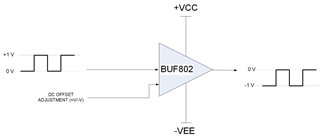

BUF802 part may be applied for my current design, which I can inject a 150 MHz Digital Signal and can adjust DC offset down to negative region as shown in the attachment.
Please advise.

    The way you could use the BUF802 with DC offset adjustment would be with a circuit like the one shown in the front end of Figure 9-6. You would inject the DC offset where "Offset Control DAC" is shown in the figure. I was wondering if there was a reason you couldn't potentially use a faster amplifier in a non-inverting gain configuration and set the output offset by injecting the DC signal at Rg.

  • In general, I would recommend to handle digital signals with comparators. That is, use something like the TLV3601 with a reference voltage of 0.5 V to detect whether the input signal is low or high, and then use a buffer like the SN74AUC1G17 with VCC = 0 V, GND = −1 V to shift the output signal. (The SN74AUC1G17 has an overvoltage-tolerant input for up to 3.6 V, so the comparator's supply must not be higher than 2.6 V.)
