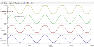

As mentioned previously, I am using the TLV9062 for signal amplification and comparison in my design, with a 3V supply. My comparator reference voltage is set to 2.5V, and I am getting the expected output. However, I have some concerns regarding the comparator output and alternative op-amps.

The design is not ready yet. Supply is 6V, that is a little too high for TLV9062. What is microcontroller voltage? Do you have access to both ZCT leads, in other words, do one side have to be grounded?
I see two outputs, VF2 linear and VF1 non linear. Do you plan to use both outputs or just the final digital output?
In any case give me the math equation(s) for output(s).

3.I see two outputs, VF2 linear and VF1 non linear. Do you plan to use both outputs or just the final digital output?
I am using only the final digital output to the MCU, and for verification purposes, I have checked the amplified output in simulation.

Amplified Output (VF2):
VF2 = (1 + Rf / Rin) * VZCT
VF2 = (1 + 82.3kΩ / 1kΩ) * 35.55mV
VF2 = 3V
Reference Voltage:
Vref = (R2 / (R1 + R2)) * Vsupply
Vref = (5kΩ / (1kΩ + 5kΩ)) * 3V
Vref = 2.5V

After placing the burden resistor, I am getting 35.55mV, which I have directly applied as an AC source. The amplified output is obtained correctly; however, in the comparator stage, the output is swinging between +3V and -3V.

Here is a lightly tested solution. LM393LV open drain comparator. For single channel, try TL331LV or TL393LV
R1 (and supply voltage) sets over current detect threshold. The VF1 voltage.
D1, D2, R2, R3 are over voltage protection, ESD/EOS
100k can be a weak pullup of the GPIO.
GPIO pulses low for over current (positive side looking only) ; uC should have a pin interrupt capability (so you don't have to watch or latch the over current detection)
