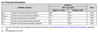

Hi Ti Team,
Greetings!
We like to know the Junction to board thermal resistance, Junction to Case (bottom) thermal resistance and Case Temp (°C) Max of TPS62918RPYR
Hi Ti Team,
Greetings!
You can find the available thermal information for this device in the datasheet. Screenshot below of what we have for this device
Britton
