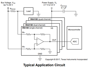

I am using INA2180A1 to measure the current across the Solenoid. Do you please check the attached schematic and confirm the connections and Current-Sense-Resistor value?

Hi Fahad,
You need a bypass capacitor to GND from Vs as shown in the image below.
Aside from that when you proceed to layout, please ensure that the shunt resistor is kelvin connected. Everything else looks good.
