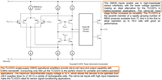

TLV2371MDBVREP is designed with CMOS Si Technology, see the block diagram below.
TLV2371-EP or TLV2371MDBVREP seems to be discontinued. TLV2371-Q1, automotive version is still available, which it may be used in certain aerospace application. But the certified Space grade of the TLV2371MDBVREP is no longer manufactured.
If you have other questions, please let me know.
