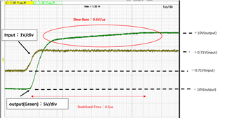

My customer is evaluating TLV9352, they are encountering the step response is slow.
The customer would like to know what could be the cause.
I would be grateful if you could advise.
---Situation
Circuit
Non inverting Gain 14
Could you please see attached excel file?
Conditions
-Input: applied in steps of -0.71V to 0.71V.
-Output: assumed to change from -10V to 10V.
Results
-Input: stable at 1us
-Output: stable at 6.5us
-The behavior of the output voltage rise is close to the slew rate in the data sheet at first,
but then become at 0.5V/us halfway through.
Question about TLV9352.xlsx
I appreciate your great help in advance.
Shinichi
  • Hi Shinichi-san,
    The output initial response seems to match what the datasheet is specified, where the output's rise time is approx. 1.2 usec ( based on 10% to 90% slew rate at the edge response in timing).
    The TLV9352 may have boosted slew rate implementation in the IC, where the long tail response may be contributed and returned to natural slew rate in the design. I did not see that the feature is described in the datasheet, and I have to verify this. In other words, ~0.5V/usec may be returned to its natural slew rate when the output is approaching to its setpoint.

  • Hi Shinichi,
    When I looked at the waveform, I also thought it might be the effect of the slew boost.
    Yes, TLV9352 (GP op amp) has slew boost feature. Typically, the natural slew rate may be 1/10 of the boosted 20V/usec. I do not know how the designer is implemented in the Silicon, and I have to locate the designer for these figure.
    This was designed by GPAMPS and it may take a few days to get the reply back from the designer. I will let you know.
    Raymond
  • Hi Shinichi,
    TLV9352 design is based on OPA2991 core, where the slew rate is about 0.5V/usec when Vid is input below 100mV, see the plot below. This is in agreement from what you observed in your test results.
    If you have additional questions, please let us know.
    Raymond
