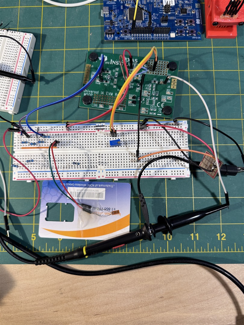

  • Hey Gerasimos,
    Here's what I'm looking at now.   This setup works...sort of.  I am finding it difficult to get a VO centered around 1.8V when I increase the gain to the point where I can see reasonable variation on the scope when moving the strain gauge.  I need quite a bit of gain to see much of anything, but when I increase it, the quiescent V0 just gets closer and closer to 0V (or VDD if I swap V+ and V-) , and my variance is < 1V.  I can deal with that if I have to, but I don't understand why I am unable to keep the output near Vref.
    In the picture:
    - VDD is 3.6V
    - The 3 resistors are 1% 360 Ohm.
    - The little protoboard off to the side is the 1.8V LDO for Vref
    - The pot in the middle is connected to Rg
    - The series resistor in line with the strain gauge is 10 ohm
    Neil
  • Hey Neil,
    So my first thought here is that the Rg node is very sensitive to parasitic capacitance and can be prone to errors if the Rg is not very tightly set. From the datasheet, as little as several picofarads of capacitance on Rg can be enough to destabilize the INA333. For a prototype, I wouldn't be terribly worried about gain error or other over temperature errors, I would probably just focus on stable operation of the device first.
    If you want to prototype a variable resistor on Rg, I would probably solder the pot directly to the pads at Rg, and remove any other connections to Rg besides the pot.
    Gerasimos.
