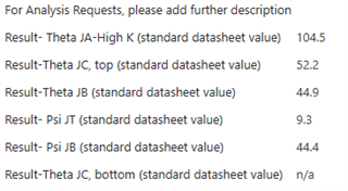

I am looking for thermal resistance values for TLE2022AMDR. Can you please tell me what the junction to case value for this component is and if available, what the junction to board value is?

Hi Matthew,
Here is the simulated thermal information about the TLE2022AMD op amp.
If you have other questions, please let us know.
