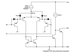

Hello colleagues,
The question is related to LM2901A-Q1,
when it is not powered (Vcc=0)
What happens in these conditions:
- If one output port is pulled up to Vx (e.g. to Vx= 5V).
I assume it is not conducting, and nothing goes wrong, since it is an Open Collector up to (at least ) 36V.
Is this assumption correct?
2. If one input port is pulled up to Vx with a Rx resistor (e.g. Vx= 5V, Rx= 10 KOhm)
Taking into consideration the simplified schematic of the datasheet (depicted above), nothing should happen,
but it depends on the breakdown voltage levels of the diodes and of the EB junctions of the pnp BJTs.
Will the input port leak any current into GND or Vcc?
