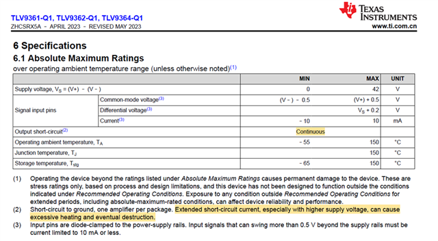

In DS, the TLV9361-Q1’s Output short-circuit is “Continues”. Does this mean the Output Pin can be connect to Ground for long time without risk?
But in the note (2) says “Extended short-circuit current, especially with higher supply voltage, can cause excessive heating and eventual destruction.” How to understand this?
