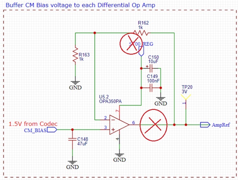

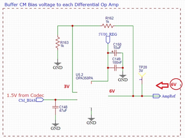

Hi again,   and . I am finally back on to trying to debug this board with the OPA350. See original thread you were helping me on "Measured output is double simulated (expected) output level".
As requested, I have removed the OPA350 and I measure 6V DC on TP20 (which should be ~ 3V DC).
For completeness:
OPA350 voltage readings at each pin:
pin 2: 3.0 V
pin 3: 1.5 V
Pin 4:  0.0 V
Pin 6:  6.0 V
Pin 7: 4.9 V
Other test point voltages:
TP3:  12V
TP5: 3.2 V
TP10:  0 V
TP19: 3.2 V
TP18: 4.9 V

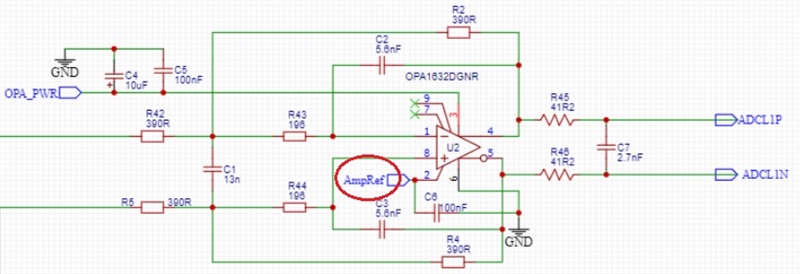

Voltages on OPA1632 pins:
pin1: 6.1 V
Pin2: 6.1 V
pin3: 12 V
pin4: 6.1 V
pin5: 6.1 V
pin6: 0 V
pin7 12 V
pin8: 6.1 V
pin 7 is supposed to be not connected (refer below schematic)

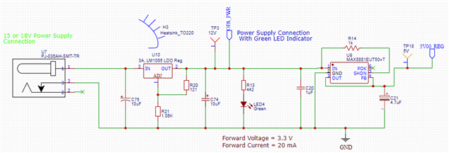

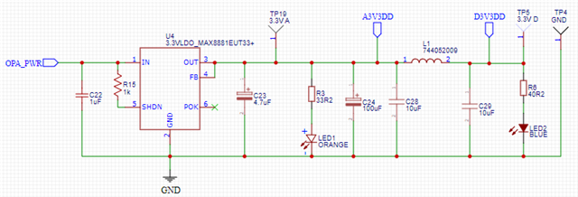

And other parts of the power supply portion of my schematic, and repeating the path to my APO1632's:
demonstrating pin 7 of OPA1632 on PCB layer
Any tips on how I can narrow down this problem with the above supplied information now?  Many thanks!

    The reason output is always 6V is because that node is being forced to 6V by something more powerful than the op amp.

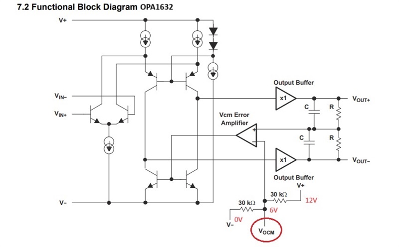

  • Mark,
    The fact that after removal of OPA350 you still see at the output 6V should not come as a surprise when you consider that AmpRef is connected to Vocm (pin 2).
    When there is no external driver for Vocm (pin 2), OPA1632 Vocm is driven by the internal voltage divider to mid-supply.
    Below please find the OPA1632 functional block diagram showing Vocm being driven to 6V with supply voltage (V+) of 12V - see below.
    All in all, the most likely reason why you see AmpRef (Vocm) at 6V instead of 3V is a faulty connection of OPA350 supply voltage or its output pin - see below.

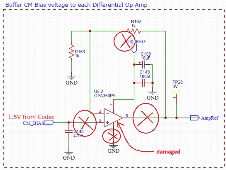

  • Mark,
    The only explenation for why OPA350 is NOT able to drive AmpRef to 3V is that its output is in a high impedance state.  This is only possible if:
    1. OPA350 is damaged
    2. a bad connection between pin 6 and AmpRef
    3. a bad connection between 5V supply and pin 7
    4. a bad connection between CM_BIAS and pin 2
    5. a bad connection between ground and pin 4
    Thus, do not look anywhere else since the problem is only around OPA350.
  • Thanks .  Since my OPA350's are thru-hole's I'll replace it and re-test just to rule out damaged device.  In point 4 above, did you mean: "a bad connection between CM_BIAS and pin 3"?
    Also, when you say "a bad connection", can you provide me some more information about what you mean by this and what I should test for to prove this "bad connection"?
    Many thanks!
  • sorry for the delay
    I believe Marek was referring to having a cold solder joint (not good connection)
    Chuck
  • Yes. i meant a bad connection between CM_BIAS and pin 3.  A bad connection may be caused by any number of things:
    - cold solder joint
    - frayed or exposed wires causing unintended shorts
    - loose connections
    - corroded connections or insulation
    - faulty switches, etc,
