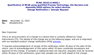

LMC6482: Recent Datasheet Change (Rev I and Rev J)
Part Number: LMC6482
I just got a PCN about the part number in the title. What surprised is the degradation of CMRR for certain part numbers, as in the worst case as much as 5dB down. This affects some receiver designs performance, so why TI make a running change on this. Is the recent migration to RFAB and die change (shrink) the reason behind this datasheet update?
