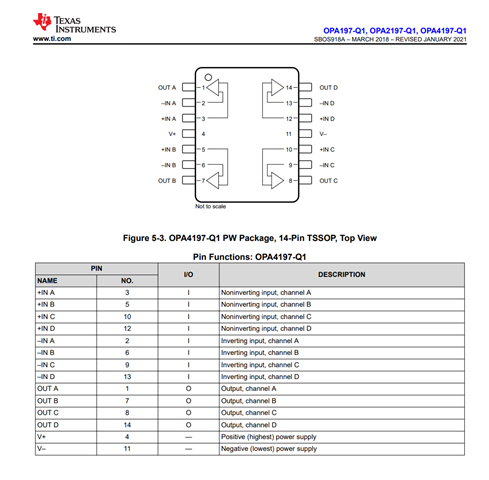

Part Number: OPA4197
What do I do with unused pins of this quad package op-amp?
Plan on using all pins except for 5,6,7
What do I do with these pins?
P/N: OPA4197QPWRQ1
P/N: OPA4197QPWRQ1
Hi Kane,

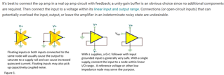

Here are some of application note and references for configuring unused op amps in a package.
The best approach is to configure unused op amp in a buffer or linear operating mode, see the attached links.
https://e2e.ti.com/blogs_/archives/b/thesignal/posts/the-unused-op-amp-what-to-do
If you have other questions, please let me know.
