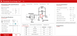

I'm looking for a space TIA GBW 500MHz. In the space TI catalogue I found the LMP7704-SP but it GBW is too low. Any advice? Thanks in advance

Here is more inputs:
- Expected photodiode capacitance: It will depend on the reverse bias voltage, but it will be between 10pf and 200pF.
- TIA gain: The photoreceiver conversion gain shall be between 1500 and 2000 V/W
- The slew rate of the photoreceiver shall be greater than 2,000 V/μs.

Hi Aditya,
Can I determined that by design? Actually I'm not able to find a device that is space qualified and as a GBW of 500MHz. (The photoreceiver 3-dB bandwidth shall be DC - 450 MHz.)

Hi Frank,
As per your requirements, LMH6702QML-SP (1.7GHz, 3000 V/µs) seems to be the best fit. You can see in the tool image below with a Rf = 125 ohms, has a TIA bandwidth of ~500MHz.
Tool link: https://dev.ti.com/gallery/info/TIA/Photodiode_Circuit_Design_Tool_LMH6702QML/ver/1.0.0/
Let me know if you are interested, I can perform a TINA simulation of the TIA circuit, with details results.
