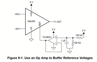

  • That module is garbage; remove R4 and R5. You can generate the reference voltage with a resistor voltage divider, but then you should buffer it with an opamp.
  • Thanks for getting back to me so soon,
    If I simply desolder the resistors, should I still see a valid voltage on the output? Or will I need the buffering plus path to ground as you say? Currently I am simply feeding the VRef and VOut pair into my ADC (based on an AD7771, but I also have an OpenBCI Cyton using the ADS1299) as a bipolar input. I should be able to configure this as a single-ended input though; as the module currently stands this hasn't seemed to have any effect, but I can try with them removed.
    Are there other things on it you'd consider garbage?
    Cheers

    A schematic example of how to drive the ref pin with a low impedance source is below (from the INA350 datasheet):
    Internally, the reference pin goes to an op amp configured in what is referred to as a difference amplifier.
    Essentially you can think of this as two resistor dividers, one that feeds into the non-inverting input of the op amp, (1: resistors between output of A2 to REF) and one that the op amp (A3) controls (2: Resistors between Output of A1 to VOUT) . The op amp is going to try to force an output voltage to set the inverting input equal to the non-inverting input. When all these resistors are equal to each other, the gain from A2 to Vout and the gain from A1 to Vout are equal in magnitude but opposite in sign, so the output at A3 is VoutA2 - VoutA1 (which is where the difference comes from). Adding impedance onto your ref node will imbalance the resistor divider seen on the output of A2, and will now no longer give you an equal scaling for your A1 and A2 outputs.
    This will give you an unexpected output gain/scaling (generally referred to as gain error), but may not necessarily manifest as too high of "noise".
    It's not inherently clear what gain the INA333 is configured in. I wasn't able to find information on what the value of R2 is. However, it's important to note that the noise specified in the datasheet is input-referred noise. This means that whatever gain you have will multiply the input noise and show up on the output.
    In very high gains, you may see higher than "expected" noise on the output, as this input-referred noise value will be gained up and seen as output noise.
    Additionally, for very high impedance sensors, there is another effect at play. The INA333 is what is called a chopper amplifier. This amplifier uses high frequency switches at the input to drastically reduce the DC offset of the device due to the mismatch in the input transistor differential pair. Here's a good overview of chopper operation and how to optimize the performance of your chopper circuits. https://www.ti.com/lit/wp/sboa586/sboa586.pdf. In a shorter-form explanation, the switches have small spikes in input current when switched on and off. When these small current spikes find a high impedance input, they can generate a substantial voltage relative to your input signal amplitude. These input spikes are then amplified by the INA333 and seen on the output.
    Let me know if any of the above sound like likely culprits for the noise you are seeing, or if you have any further questions!

  • And if I feed that into either my ADC or an op-amp, the input impedance should be very high and in a perfect world it's a voltmeter that has no effect on the internal system and is indistinguishable from an open circuit, so that impedance doesn't affect it in the same way(?)
    Almost, this is where the understanding left the rails. Ideally the reference voltage would be applied from a low-impedance source (like the output of an op amp, or a voltage reference)

  • Almost, this is where the understanding left the rails. Ideally the reference voltage would be applied from a low-impedance source (like the output of an op amp, or a voltage reference)
    Okay, as I type this I only just realised that the triangle in your diagram is pointing the other way (I said I wasn't very good at all this!!). I was reading left-to-right and my mind was seeing the two pins as in the 333, apologies.
    So in very simplistic terms (I'll ignore the capacitor, presume it's for smoothing) - the two 100k resistors are just a voltage divider generating a 2.5v reference. This goes to the non-inverting input of the 9041 in your diagram, which tries to drive the output to the same voltage and so the whole bottom-right is just acting as a voltage source, which is "conceptually" going "into" the 333 to set the reference voltage as the midpoint, if you'll forgive the "loose terminology".
    If I've got that right this makes sense; I understand with electronics you don't always get as clean a concept of input and output the same as other fields, in that it's a network and current can flow all over the place (and I need to start rotating the page 90 degrees or reading right-to-left more and then I might understand things that seem beyond my knowledge at first!) But the way the original board was laid out moved my mind to thinking of VRef as an output. But it makes sense to me as something you want to peg at a given place and leave it there, so we want the output of an op-amp.

  • Hey Ben,
    This is correct!
    Yes, in circuits there is a bit of "relativity" where you can both think of VREF as an input (the input into INA333) but also it is an output relative to the op amp that is generating it.

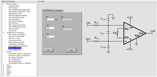

  • Another quick question on this module - is there a good reason (i.e. general good practice - understand there may be other be application-specific reasons, but I don't know what parameters the board designers were using) for the two caps to ground on the input pins?
    I have been reading through the documentation and learning about properly managing bias current etc. and now have trying out several different permutations in TINA to try and make sure I can reproduce different scenarios and verify I understand correctly. Initially I have left those caps in as I simply wanted to start by mocking up what I have in front of me. But it seems the 50Hz rejection in simulation is better if I simply take them off. At first I presumed they might be used as bypass capacitors as with on the power supply pins, but now I look through the datasheet again, and a few different circuit mockups I've seen, I don't think I have seen capacitors on the inputs except where there's a specific filtering reason based on the input signal that's desired.
    In my case it seems that they're not helping for the frequency ranges I'm interested in - before I heat up the iron and try removing them, is there a reason I might want to keep those around the input pins?
  • Hi Ben,
    You can add capacitors to the input pins for input filtering to reduce EMI or noise. We have the recommended how to design and size these capacitors in the Analog Engineer's Pocket Reference as well as a tool in the Analog Engineer's Calculator.
    Analog Engineer's Calculator:
    Please let me know if you have any questions.
    Thank you!
    Ashley

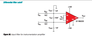

  • Hey Ben,
    Some additional context here, these capacitors to the input provide common-mode (same signal on both inputs) and differential (different signal on each input) filtering.
    This helps externally filter your common-mode and differential signals. However, this implementation is incorrect, and there should be a cap between each input that is at least 10x larger than the cap on IN+ or IN-. This capacitor between inputs prevents any capacitor mismatch from generating a differential signal on the instrumentation amplifier inputs, increasing your error.
    Gerasimos
  • Okay, so as expected, poorly-designed off-the-shelf filtering - thanks both of you. The TINA simulation indicates it's better without and removed them on one board and not really seeing any improvements so still trying to work out the dependent variable. Trying to see if I can get hold of some better test equipment. And/or will just knock up a vanilla board with everything done according to the comments here/datasheet and see if that's any better.
