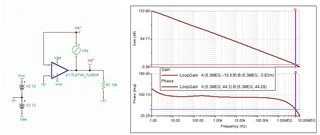

A my account wants to know how to measure the open loop gain of tl082. which equipment are used in TI for open loop gain measure? any recommendation equipment for open loop gain measure?

This is one of the technique to simulate in Tina or other tool, which is similar to a lab measurement.
BTW, TL082 has issued PCN recently, and the current op amp is manufactured from the RFAB, and it is different from the simulated model (the technique is the same).

TL082 Aol Simulation 05092025.TSC
To do this properly in the lab, you would need a network analyzer and injection transformer. For lower cost approach, you can get Bode 100 and Picotest J2100A Injection Transformer, see the link below.

How to test the open-loop gain in TI BU? any application note for this type of measure?
from the analyzer, the inverter is used to measure the closed-loop gain, then open-loop gain is calculated. it is not directly test open-loop gain.

We do the open-loop gain circuit similarly. It is all the same theory with minor different implementation, where LoopGain = Aol/Acl, if you know any of two two parameter, you can plot out the third. So if you know Acl and Loopgain, then you can calculate Aol and vice versa.
This is stated in the video training below.
