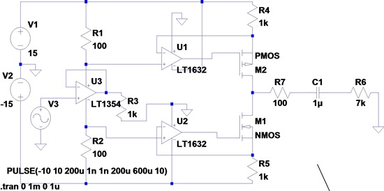

  • Hi, I guess I found yet another circuit that may do the job (see graphic), but somehow I couldn't get it to work. I tried with the given components and the negative phase works fine but the positive phase is blocked....
    Could you give me a hint with which components of yours the circuit would work?
    The MOSFETs should be power MOSFETS and U1 & U2 rail-to-rail OPAs....R7 is used as sensing resistor to monitor the current and voltage drop over the load (C1 & R6).

  • Tim,
    To start, I think you should look at the power supply connections on U1. I also don't think this circuit will be able to provide 10mA to your load. No matter which circuit topology you chose, it still must obey Ohm's Law, which requires you to apply 70V across a 7kOhm load in order to get 10mA through it. Without a 70V supply, one possible route would be to search for a wideband transformer that would allow  you to step-up the output voltage across the load, however this will definitely affect your pulse shape.
