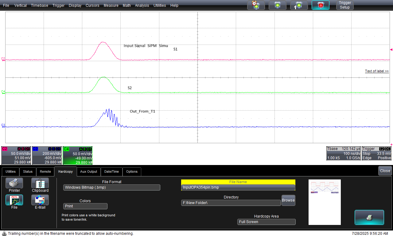

    Dear Sima,
    I am attaching the scope plot of the oscillation as indicated above:
    Oscillation Issue
    • Oscillations are observed both at the input and output of the TI transformer (Balun).
    • The oscillation manifests sharply on the falling edge of the signal.
    • Despite efforts, the origin of this oscillation remains unclear.
    • The bandwidth and gain of the OPA354 filter out this oscillation at its output.
    • Relevant diagnostic materials include the schematic and oscilloscope screenshot labeled Probe_1_Out_TIA.

    Thanks for the scope shots! That does look like ringing on the pulse signal. Would you be able to probe at R32 and R33? If you still see the same issue, please follow above bullet points after checking if SiPM is current output rather than voltage. Also, what is your SiPM internal capacitance at your set reverse voltage bias?

    Yes on R32 and R33 I still have the some ringing on the pulse fall.

    1) I still see this ringing but the modifications have not been made at this time. The circuit is very dense and complex. It is a portable dosimeter for medical physics for measuring gamma, beta, and neutrons, and the TIA functions both as an amplifier and a mux for the three measurements at different times.
    2) I am sending simulated Silicon Photomultiplier Signal semigaussian and as you can see at the output of the second stage amplifier OPA354 is still visible the ringing.

    Thank you for the information. I would like to see if maybe this ringing is seen at the output of the LMH32404. If the customer can send the same signal and probe prior to the 2nd stage, that would be good to see if it is the TIA stage or the 2nd stage. Is there a way to decrease the input signal to see if you see this issue when the output is decreased? Another potential issue is the setup of the device. If the device is sinking current, the current cancellation circuitry must be disabled. This means the IDC_EN must be set high. It is currently set low, which I am not sure how it affects the response of the device. To rule this out I would recommend cutting this trace to ground and setting this pin high with some kind of external wire if possible. One other recommendation would be to remove the output capacitors (C67 and C70) as these will affect your phase margin. I am not sure how much it affects the circuit but it is something else I would remove for debug purposes.
    Ignacio
  • Hi Ignacio,
    Yes, I’m attaching oscilloscope photos taken at the probe point at the output of the T1 transformer balun, at the input of the OPA354 with a gain of about 10 V/V. The oscillation occurs at the output of the TIA and is also directly present at the Pair1+/Pair1- and Pait2+/Pair2- (R32-33-34-35) ringing is present also changing the peak of the input signals from 50mV to 25mV.
