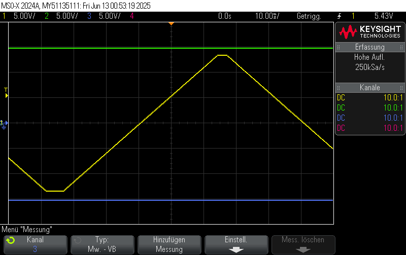

For the past 20 years, we have used the TL081C in our electronic boards, with the known specifications for VOM max. 13.5V at a supply voltage of +/-15Vsup.
We noticed that the VOM value had changed and built  test circuit on page 24, Figure 6.2 with a gain of 2. With the same Vsup +/-15V, we now get approximately 15V at the output.
These values ​​do not correspond to the known specifications in the datasheet.
I have attached a picture of the component and a screenshot of our measurement results.
I would be very pleased to receive a prompt response.

  • Hi Yasin,
    TL081x product has issued PCN, see the link below.
    https://mm.digikey.com/Volume0/opasdata/d220001/medias/docus/5488/PCN20230627002.1.pdf
    The TL081C in the new FAB has slightly different characteristics and the output voltage swing is closer to the supply rails than pre-PCN product. The output voltage swing has changed in the since SLOS081J datasheet back in Nov, 2020.
    slos081j.pdf
    Prior to the SLOS081J datasheet back in Nov, 2020 (from 2015 to 2020 period), the Vout swing are ranged from ±12V (min.) to ±13.5V(typical) specified in SLOS081I's datasheet (published in May, 2015).
    If you have other questions, please let me know.
    Raymond

  • Typical values are not guaranteed. The datasheet does not specify a maximum output swing for the TL081, so a higher output swing is not considered a functional change.
    After the PCN, the TL081 uses the same die as the TL081H (with CMOS rail-to-rail outputs). The TL081H specifications are useful to see the actual typical values of the new die.
    TI does no longer ship old dies.
  • Hi Yasin,
    Please see Clemens's comments.
    The new FAB in the post-PCN op amps are considered as the equivalent within the previous DC/AC performance specification prescribed in the datasheet.
    If you have other questions, please let us know.
    Raymond

  • Hi Yasin,
    1. Does the Change also apply to the I Type ?
    The following PCN link covers the listed op amp shown on the list, which I posted at the beginning of the reply.
    file:///C:/Users/SammyA/Downloads/TXII-N-A0015980837-1.pdf
    2. Is there a way to find out from the batch number which C type is produced in the new and which in the old factory?
    Yes, if you provide the date code and lot number of the op amp package or shipping label, the information is traceable to a FAB type.
    3. How can I understand/decode the code printed on the top side of the IC?
    For instance, 37K refers to the op amp is manufactured in July, 2023, which is the RFAB or the post-PCN product.
    Raymond
