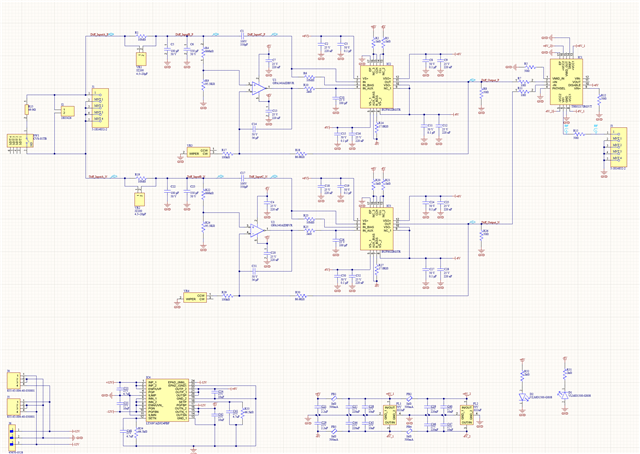

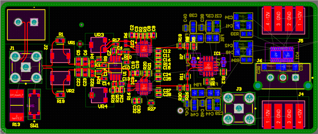

  • This is my schematic with THS3217, and it design for oscilloscope front input. it works up around 230MHz, and I would like to push the frequency as high as possible, and I have been thinking that THS3217 lower down the performance. The power supply circuit for THS3217 is complicate, and any recommend D2S amplifier that will support DC to around 1GHz in flat zone?

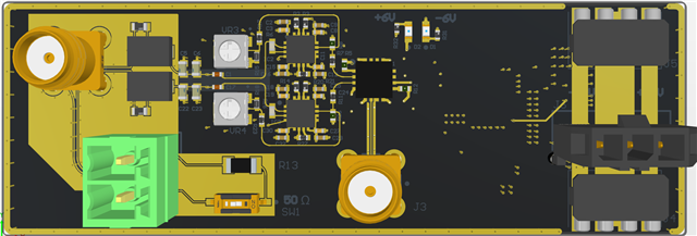

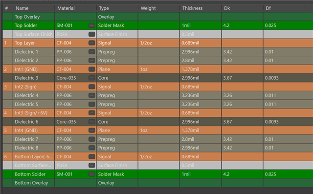

    Thank you for reply. The BUF802 will work flat around 1GHz according with datasheet, and I can't find D2S OP-amp will work from DC to HF besides THS3217 and THS3491. I did connect the network analyzer to the circuit, it does show good flat BW around 230MHz, it is for entire circuit, not just output of the BUF802. The board was designed with 0603 package, and it has large spacing between the components. I agree that match impedance path with titer layout can improve the BW. This is my first high speed PCB layout, and I am working on Ver.2 layout. I use 0402 package this time, could you share some recommendation from your experience for my layout?
    It is 6 layer board with FR408 with size of 2.9 X 1.2 inch. The board stack and layout at below

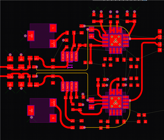

  • Hi Weyann,
    Can you share the Vpp you are setting to get the frequency response data. If it's a small signal, and the limitation is not in the BUF802 circuitry, the THS3217 should ideally have better bandwidth performance than 230MHz. If possible, could you try a small signal test if you have not done so already. For the BUF802 we got 1GHz by tuning the input circuitry to impedance match across frequency. I am curious if this could be a reason for the reduced bandwidth performance. I was able to look over the layout. One question I have is for your input, on your second branch (going through R19), that input is the SMA (J1) body from what I can see. Is this the intention of the circuit? I am wondering if this is also causing reflections of some kind resulting it lower bandwidth. I would suggest adjusting the decoupling capacitors from 0.1pF to 0.1uF, I am not sure this small of a capacitor would be all that helpful. I would also suggest putting the decoupling capacitors as close to the supply pins as you can. The row with C11 should ideally be moved closer to the pins. Overall, the layout does look compact which is ideal for something at these speeds. I would suggest looking over the layout we have for the BUF802EVM as this would be the best reference we have for how to ideally layout this device.

  • Hi Ignacio,
    Thank you for the information and suggestion. I had tested this circuit with network analyzer which will be small signal test right? The VR1 and VR2 that pair with 10M resistor are adjustable capacitor. I add C5 and C22 to increase input capacitance of BUF802, so I have enough room to composite the capacitance with VR1 and VR2.(the C6 and C23 will be DNI, it is for future update for 50:1 or 100:1 divider) I agree that J1 SMA pair with J2 Molex will cause reflections, and the Molex is for twisted pair cable. Do you have suggestion or connector can improve the impendence issues? I changed the Input and output signal trace of BUF802 from top layer to layer 3 with blind via, the trace width can only be 3.7 mils according to Altium impendence calculation. should I stay on top layer? The Via size is 7mil hole with 11mil diameter and 4mil expansion top.
    Weyann
  • Hi Weyann,
    Yes, that is correct, if you were using some kind of network analyzer with a small signal (~100mV), your limitation in the performance should not be the THS3217 as it has significantly more bandwidth performance than 230MHz. This lower performance is likely due to the input structure of the BUF802 circuit. I assume you are trying to capture a differential voltage at two nodes; I am not sure what would be the best way to do this other than some kind of coaxial setup with an SMA like you have. For this circuit to work with a high input impedance setup, the tuning of VR1 with the capacitive network C5 (plus any parasitics) I believe would have to be precise in order to get the right response. Do you notice the bandwidth significantly changing as you tune VR1/VR2, whether it improves or degrades further? This would help us understand if the bandwidth performance is due to this portion of the circuit. For the layout, we try to limit any traces that via to different layers as this is not ideal for high-speed signals. However, we did via the feedback portion of the traces to the OPA140 but kept the feedback network close to the output of the BUF802. For the signals going into the BUF802, I would suggest keeping these on the top layer and try to get them as close to the input as possible, as additional trace length also results in inductance. I attached the BUF802EVM for reference on how we laid out this board.

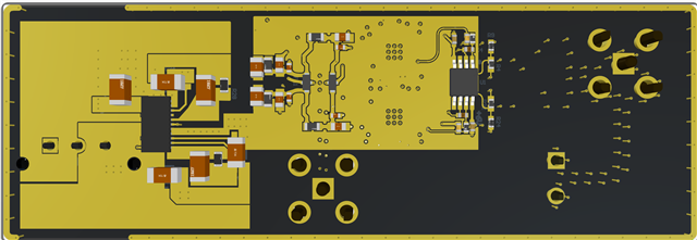

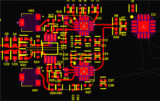

  • Hi Ignacio,
    Sorry for the late reply, I re-layout and size down my board to 1 X 3 inchs. I followed with your recommendation above, and make all the HF trace on the top layer. The VR1 and VR2 will effect the frequency response if not tune it right. We have to calibrate each of them by hand. If this layout/design goes well, I will like try digital capacitor with edge card design. I want to calibrate it automatic with software. At last, could you take a look the THS3217 on my schematic? is there anything that I miss? Thank you.
    Weyann
  • Hi Weyann,
    I was able to look through your THS3217 schematic and I do have a couple suggestions. I believe for the VMID_in pin you can leave this floating if not using the buffer. R5 can be removed and would help reduce any space needed for the circuit. The same idea would apply to resistor R12 since you would not be using this path. For the input pins is there a reason you require the 50ohm resistors to ground? (R8 and R26) We have these on our board to impedance match with the previous stage's 50ohm series resistors. If everything is close together on a single PCB you wouldn't need to impedance match, and in this case the buffer is driving a heavier load by having those resistors to ground. R7 and R11 should be fine. For the pathsel pin, I would consider setting this pin high, which could cause the output of the D2S stage to go to pin 9 and leave pin 9 floating. I am not sure how the non-inverting input of the disabled OPS would behave so to be safe it might be better to set this D2S output to pin 9 as it is floating anyway.
    Ignacio
  • Hi Ignacio,
    Thank you for the review, and yes that path select pin should be high. I did experience some signal output at VOUT pin11 with disable OPS, and I was wondering why? Thank you again.
    Weyann
  • Hi Weyann,
    Ideally you should not see anything as it is disabled but potentially some signal is feeding through an input diode and is being seen at the output through the feedback resistor but ideally it should not be seen.
