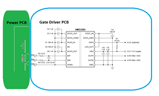

My team's design has 2 PCBs where AMC3302 can be placed:
Power PCB: where the Switches and power storage (inductors/capacitors). High switching noise and magnetic fields exposure
Gate driver PCB: Shielded from noise PCB, used to generate the pulse drive for the switches
What is the preferred placement of AMC3302 for best and accurate current measurement by the controller?
Option1: Shunt resistor is in on the power PCB and the AMC3302 on the gate driver PCB
Option 2: Both Shunt resistor and AMC3302 on the power board and output to the controller get routed through Gate driver Board
