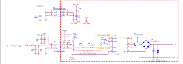

I would be grateful if you could review the following points and share your insights:

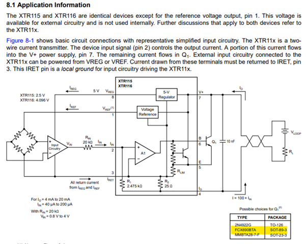

  1. I have reviewed the datasheet and am currently using the recommended FCX690BTA (SOT-89-3) transistor.
    • Is this package sufficient to handle the thermal dissipation in my design?
    • If so, could you recommend a specific TR that is more suitable in this package type?
    • If not, would you suggest switching to a different package?

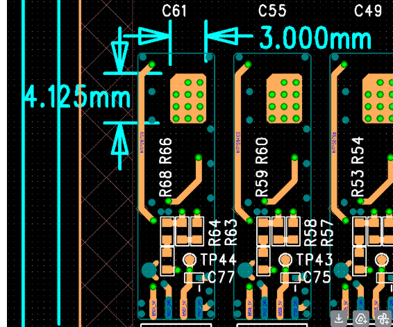

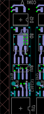

  2. How much should I increase the copper area in order to improve the thermal performance in this situation?
  3. If there are any improvements you can suggest on the circuit design itself, I would greatly appreciate your feedback.

  • Hello Rakyoung,
    Your post is talking about previous messages, but I could not find any other posts by your account. Could you please include any other conversations so I may know what other details were shared?
    If this is not possible, could you please provide the following information.
    1. What is the value of VB+?
    2. What is the maximum current out of your Q8 transistor? I'm assuming it will be 4.3V*100/10k (43mA), since this is the maximum output of ADUM4195 with a 5V supply.
    If you are trying to implement the reverse voltage protection like figure 7-2, D16 and C61 should be on the other side of the voltage rectifier (D15). They should be connected between Pin 7 and Pin 4 of the XTR116.

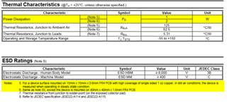

    For the power dissipation of the FCX690B, please see the below highlighted thermal characteristics. The transistor can dissipate 1W continuously with a 15mm x 15mm x 0.6mm  PCB with a 1oz copper pour in still air, and 2W continuously with a 40mm x 40mm x 1.6mm PCB. With 43mA of output current, your maximum supply voltage that will
