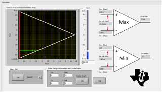

    Thanks for the update. As per the datasheet, the Vcm range is V-(+0.1) to V+ (-0.1V). But above 0.2V to 0.8V range, the op-amp is not workable. Could you please let me know why it is not working? See the below image for reference. Could you please look at it and let me know what the issue is with this?

    Please see the reference image that I have provided, where the Vin+ and Vin- connections that are connected respect to PIN3 & PIN2 of the Op-Amp. About reference pin 5, It is GND. There is no load connected at output Pin 6. The supply voltage of the op-amp is 5V, and the Wheatstone bridge voltage is 2.5V. (In image mentioned 5V, which is wrong mentioned).
  • Hi Jigar,
    Thank you for the information. With the conditions mentioned above, you are limiting the output voltage swing range which is why the actual output is not as expected. This behavior cannot be seen in simulation and is calculated via the Vcm vs Vout plots or using the Analog Engineer's Calculator.
    I recommend trying to change the resistor values to increase the input-common mode voltage or increasing the wheatstone bridge voltage to see if this helps to fix the output issue.

    The common mode voltage is determined by the resistor divider that is constant in the Wheatstone bridge (Vin- leg in this example). So, depending on the excitation voltage and resistor ratio, this will change the voltage measured at Vin- and change your input common mode. I've attached a TINA simulation showing different examples of how this voltage changes with the different excitation voltages and if you add a resistor between the bottom leg and ground (R5). The design information on this is further explained in this reference design: Single-Supply Strain Gauge in a Bridge Configuration Reference Design
