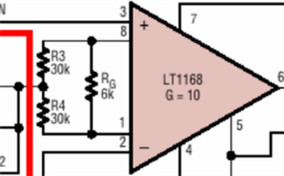

1) Gain resistor network.
Some designs I see tap the common-mode signal across two gain resistors:
Other designs add a third in parallel with these two:
Could anyone please explain the reason for this third resistor? Is it just for component matching/tolerance, or does it relate to having a buffer or not before the inverting amplifier? How should I select appropriate values for the downstream amplifier and for the appropriate gain of the INA?

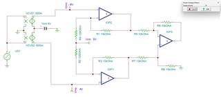

    1. Gain networks.
      The variance in different gain resistor networks could either be to target a specific thevenin equivalent resistance, but the ultimate goal is to generate a voltage reference point that is equal to the common-mode of both of your input amplifiers. Handily, the midpoint of the voltage across Rg is your common-mode.
      Below is a circuit created with ideal components. The input VCVS devices are configured to allow VG1 to set the input voltage differential, and the DC source VCM to set the input voltage common mode. In an instrumentation amp, the value of the input common-mode voltage is going to be the average of IN+ and IN-, Vinp and Vinm. If you were able to tap the exact midpoint of a single gain setting resistor, the voltage at the middle of that resistor would be equal to your VCM. Since most resistors don't have a midpoint tap, we use two resistors and tap the midpoint there, and do the math to get the correct equivalent resistance. Ultimately the Instrumentation amp (IA) does not care if you have two series resistors, or 500 series resistors, it cares about the equivalent resistance seen between the RG pins, so to the function of the IA is unchanged, and you have a handy point where you can sense the common mode.
      Here's the TINA-TI sim if you would like to poke around: Ben_Ideal_INA.TSC

    All so that in a totally ideal world, zero current flows from the tap in the gain resistor network to the OpAmp, zero noise or stray voltage from the OpAmp affects the gain network, and the network sets the appropriate gain(?) We therefore use the third resistor in parallel with the other two if we can't find a good solution with just a 1:1 voltage divider.

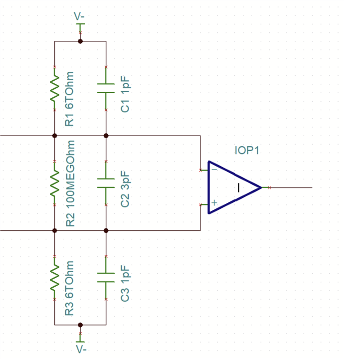

    Yes, but you can verify with the input impedance spec of the op amp, and it need not be expensive. The TLV9351 has the following input impedance, and the equivalent resistance network can be seen below.
    For ease of math purposes, we can assume that the impedances are tied to V- of the amplifier.

    The addition of the 12.7k resistor is there to set a maximum gain of the error amplifier.

    So then, is the resistor network more just about picking a third resistor to cancel out any mismatch in the tolerances in the first two? I guess I'm a bit lost as to where I should start in choosing values and how to hook the inverter in, for a given equivalent resistance/gain and given OpAmp.

  • Hey Ben,
    No worries! Yes, adding a sufficiently smaller third resistor will cause the smaller resistor to dominate the error analysis. If you are looking at how to add in an integrator, the easiest method would be to buffer the mid-voltage point. This will remove the need to calculate complicated resistance networks and their resultant effects on the equivalent Rg.
    If you have a matched pair of resistors that has good absolute and relative tolerance, this could be a good candidate, as you will not need to use two imprecise resistors and one precision parallel resistor.
