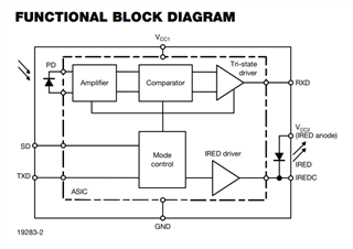

Actually I am implementing discrete IrDA receiver.In my earlier board I used an IC from Analog devices.It is not automotive qualified.So decided to go with discrete implementation.Below is the block diagram of the IC.
In the receiver section you can see that a trans-impedance amplifier + BPF + Comparator.
In my circuit I am using TIA + Comparator.I am using this opamp (OPA859-Q1) for my application.I use this opamp for TIA.

In that case what will be the pass band frequency.
Also I found some other transceivers without BPF

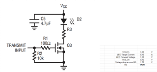

This is my IR LED. Below is the IR LED Circuit.

Hello Hari,
Thank you for the update, I am glad it worked out!
Sima
