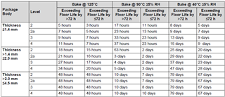

    This device has infinite floor life, therefore bake is not necessary.
    However if customer does perform bake, it is recommended to keep temperature below 125-degree C, following the suggestion given in this table.
    At high temperatures, we run the risk of oxidation and intermetallic growth, which may cause solderability issues.
