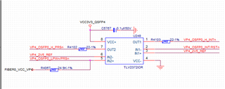

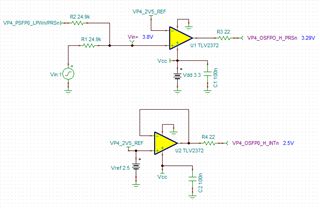

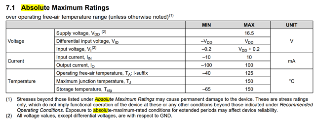

input voltage:VDD+0.2V,Is the maximum allowed voltage for the representative IN 16.7V? Or is it the current VDD + 0.2V? If there is an overshoot at IN, can you provide the allowed overshoot time?
Is there a type that has pin-to-pin connection with TLV2372IDR, but with an IO voltage that is allowed to be greater than V+0.6V?
