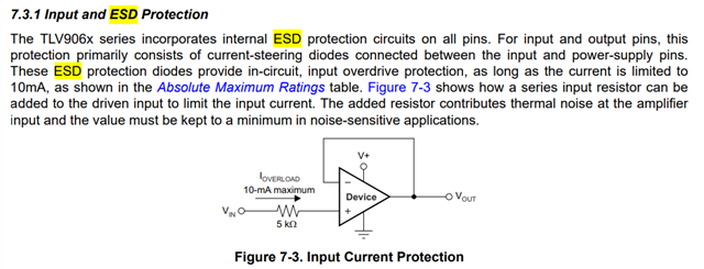

Hi Team,
For TLV9062 it shows the below typical application, could you please help to check how customer determined the largest input resistor they could add at the device in+ pin? The datasheet mention use a minimum resistor at a noise sensitive system, but it doesn't mention the up limitation for this resistor. Could you possible help to double check? Thanks a lot for your help.

  • Jie,
    As large as you like considering input does have a small amount of input bias current (more at high temperature) and a couple picofarad of capacitance.

  • Jessica,
    The resistor noise adds to input signal.
    The formula for calculating thermal noise voltage in a resistor is V = √(4 * k * T * R * Δf), where: V is the RMS noise voltage in volts, Boltzmann's constant (approximately 1.38 x 10^-23 J/K), T is the temperature in Kelvin, R is the resistance in ohms, and Δf is the bandwidth in Hertz.
    Assuming 1% noise of 0.0418V at 300 Kelvin, F = 10MHz , limits R to 10 G

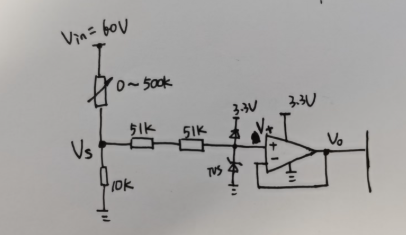

  • Hi Ron,
    Below shows customer design, their application is want the output voltage between 0V~3.3V, even with input voltage of 0~4.1V; It will be fine for customer application when the input above 3.3V, the output can keep 3.3V.
    From datasheet, we think customer could use under that kind of condition as long as we limit the input current less than 10mA, correct?
    Best regards
    Jie
  • Jie,
    Yes.
