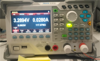

I am Designing a Buffer Circuit using LMH6321MRX/NOPB IC to Amplify the DAC Output Current. The Load requires atleast 150mA Output current for which I was testing the IC with the following connections.
Pin 1,2&8 are left open.
+10V & -10V is supplied to the IC pin 7&4 respectively through a .1uF Cap which is given to common Ground.
3.3V is given as input to the PIN 3 of the IC and Pin 6 is connected to the Load Generator.
As I increase the Load Current from 0 to 100mA the voltage drops gradually from 3.3V to 2.8V at 90mA load but at 100mA Load the voltage drops to 0V. The IC Datasheet specifies that it can give upto 300mA of Buffer. Am I missing something in the connections?

  • Hi Sudhir,
    With these supply voltages, this should not be happening. You should expect a reduction in output swing as you pull more current but not at these levels. I am wondering if maybe you have a current limit set at your supplies potentially and it is hitting its limit? You can set this device to +/-15V and should have no issues. The same idea will apply if setting -3.3V at the input for example. The consideration is not hitting the device's output range with either input polarity.
    Ignacio

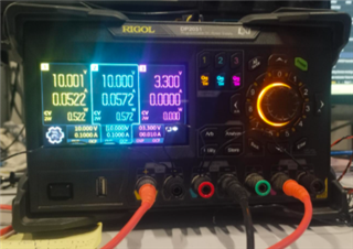

  • Hi Ignacio
    I had previously set the current limit to 0.1 A, and after increasing it to 1 A, the device is now operating without any shutdown issues.
    However, I’m still observing a voltage drop at the output. To investigate further, I connected a 33Ω resistor at the output and applied an input voltage of 3.3 V. Under this condition, I measured a voltage drop of approximately 0.6 V at the output. Is this drop the usual behaviour of the amplifier?

  • Hi Sudhir,
    Thank you for confirming your configuration. I believe this large drop is due to the voltage drop across the internal output impedance of the device. The output impedance of this device is around 4.3ohms, with the load you have you would expect a drop through this internal resistance of around 0.38V. Another reason you would be seeing this which is adding to the output error, is the voltage gain of the device. For this device, in a loaded condition (>200mA) the internal gain reduces to around 0.92V/V. I believe it is the combination of these two things that is causing this drop.
