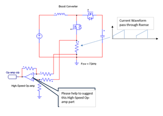

Customer looking for amplifier Rsense signal of circuit below by using High speed Op-amp. The circuit and waveform in picture below.
Please you help to suggest TI Single package for High-speed op-amp for this.
Hi Vannisa Kaewkot,
You have selected OPA354 which is one of the amplifiers used in this application. However, to select the right amplifier, I would need more information like supply voltage, shunt resistance value, acceptable error. You can use our online Analog circuit design studio tool to choose the right amplifier. Select shunt current sensing in the link mentioned. If you need further assistance, please feel free to open this thread.
