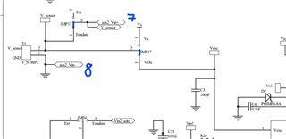

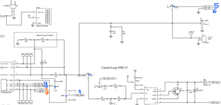

    I would be happy to debug with you, lets start with J3 and J4 of the USB DAQ board, the following are expected from Test board:
    J1 mates with J3 in the USB board:
    J2 mates with J4 in the USB board:
    Here is where they are connected to on the PGA309 Test board:
    On your EEPROM:
    Pin 1 of the PGA309:
    Pin 7, 9, 12, 13, and 14 of the PGA309:
    A note on power supplies and ground, I would connect "VDUT" to the power supply of the PGA309 (pin 10 & 3). I would connect all grounds from the connector to the ground of your board... maybe its missing a ground return path and that's the reason the destruction to the board is occurring.
    Please let me know if these connections are made and if you are still not getting the desired result.
