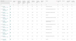

The link below is our chopper amplifiers' selection.
https://www.ti.com/amplifier-circuit/op-amps/precision/products.html#2192=Zero%20Drift&
If you have other questions, please let me know.

Here are other quad chopper amplifier selection.
https://www.ti.com/amplifier-circuit/op-amps/precision/products.html#480=4&2192=Zero%20Drift&
Raymond
