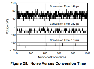

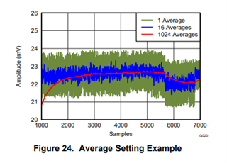

    The offset doesn't directly affect the measurement resolution, but rather the smallest current that can be measured without calibration. The resolution is highly affected by your conversion and averaging settings, per these figures:
