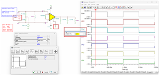

    I'm sharing the TINA simulation file I used for testing:

    I made a couple of adjustments to your schematic as listed below and re-uploaded the TINA simulation. Please let me know if there are other adjustments you need to fit your application better.
    • Reference voltage was shifted to GND. The reference voltage will shift your output signal, so if you need an output of 0-2.5V, the reference voltage has to be 0V.
    • Input signal range was adjusted to match the conditions you listed. I changed to a square wave to better visualize, but this can be changed back to any waveform shape. The input conditions were stated to be 0-42mV. The input signal source needs to be offset 21mV and the amplitude 21mV in order for the simulation to show a waveform from 0-42mV.
    • The output now shows an output range from 0 to 2.44V.
    sbom471 (1)--tuning-TI-edits.TSC

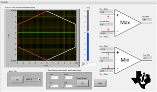

    Please note that depending on your input common-mode range, reference voltage, and supply voltage, the output swing limit will also change. This behavior is not shown in the TINA model and can be calculated via the Analog Engineer's Calculator. Based on your current conditions shown in the schematic, the output range of 0-2.5V should work with the INA826.
