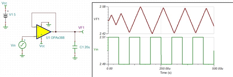

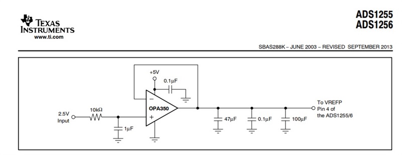

    There are very few op amps that could directly drive (with no series output resistor) 20uF cap and the one that comes to mind is OPA350 - see example below.
    However, OPA350 is nowhere near the precision of OPA388 chopper amplifier but no zero-drift amplifier can directly drive 20uF loads.  Thus, in order to assist you, it would be very helpful to understand whether you are considering OPA388 zero-drift amplifier due to its very low Vos, temperature drift, or both?

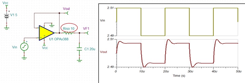

    You could use OPA388 but in order to be stable it would require an isolation resistor, Riso, of 10 ohm or higher - see below.

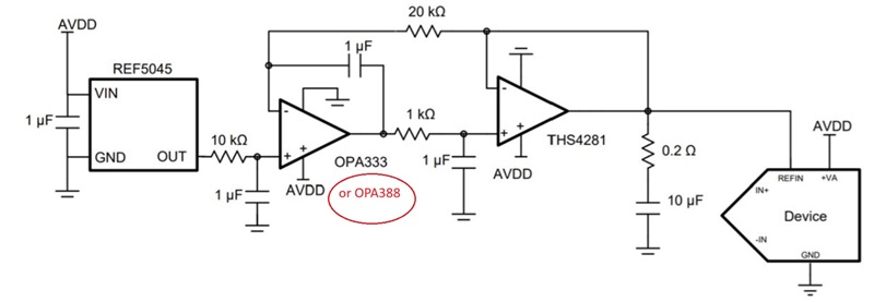

    Also, if minimizing the total power consumption is critical, you could use a composite amplifier with OPA333 zero-drift assuring precision while THS4281 controlling the settling time - see below.

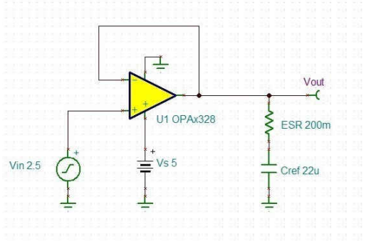

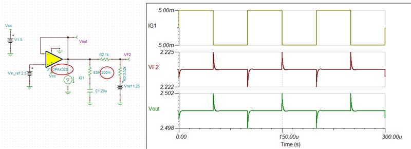

    In case the power is not important, the simplest solution may be to use OPA328 with 0.2ohm ESR - see below.

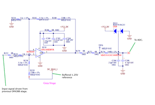

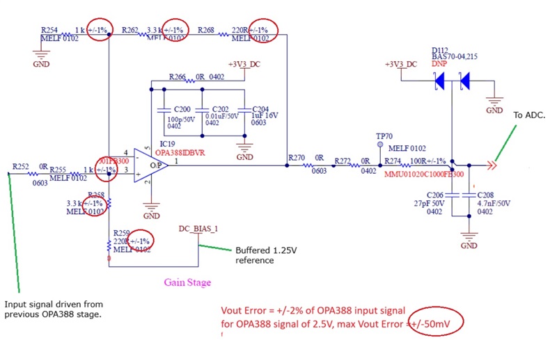

    We have 28 analog channels in our board and there are 2X 1.25V reference buffer circuits. Each of reference buffer circuit provides level shifting to 14 analog channels having 30Hz -3KHz AC (bipolar) signal. Screenshot of final gain & level shifting stage of single analog channel is as below. The final gain stage having level shifting is directly driven from previous stage having OPA388.
    Buffer current will vary as per signal & looks peak can go to ~5mA for 14 analog channel. All ADC channel going to 16-bit SAR ADC.

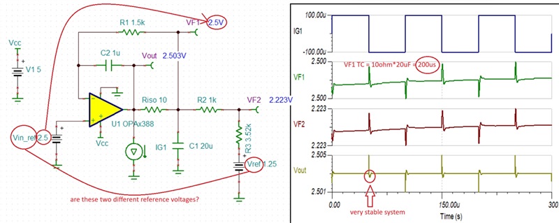

  • I am unclear as it looks like you have two reference voltages - please explain.  Regardless, in order to eliminate the gain error caused by voltage divider between Riso and R2+R3, you may implement the dual feedback as shown below.  The circuit is very stable with very little overshoot , however, the overall settling time will be controlled by the Riso*C1 time constant of 200us - see below.
    Having said that, it makes little sense to me to use OPA388 with max offset of +/-5uV and then utilize +/-1% matching resistors as they may cause 10,000 times higher output error of up 50mV (see below) - please explain.
    Below I have attached Tina-TI schematic for your own simulation.

    Thanks for suggesting above compensation scheme. I am not sure if above scheme will be suffice for SAR ADC having 180ksps sampling rate particularly when SARs having burst of transient currents. Your advise needed on this. Or do you think Riso+ DFB+ RFx will be better for SAR?
    Yes, 1% resistors are 25ppm and our product will be going initial calibration, so essentially we are only concerned about drifts.

    1. If you can tolerate the max offset drift of +/-1uV/C, the best solution would be to use OPA328 with 200mohm ESR in series with 20uF BUT no Riso. This would dramatically improve the settling time due to the elimination of Riso*CL time constant - see below.
    2. If +/-1uV/C max drift is not acceptable, the other solution would be to use a composite amplifier: OPA333 (or OPA388) zero-drift op amp assuring precision over temperature while THS4281 controlling the settling time, as I previously shown (see below).

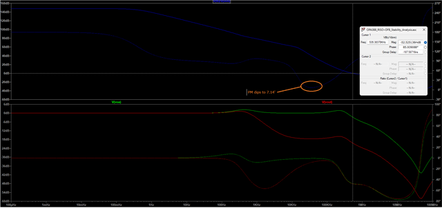

  • 3. As far as your question about my comment about possible need to lower the number of channels per reference voltage, it is based on my assumption that all 14 channels are scanned sequentially, which would result in the need for shorter settling time to 16 bits resolution.
    4. RISO+ DFB+RFx scheme is used to flatten 1/β noise gain before intersecting with AOL curve, which effectively limits phase dipping.  However, if your phase  margin does not dip below 20 degrees, I do not see a reason to implement it.

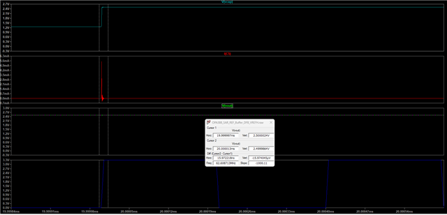

  • Hello Marek,

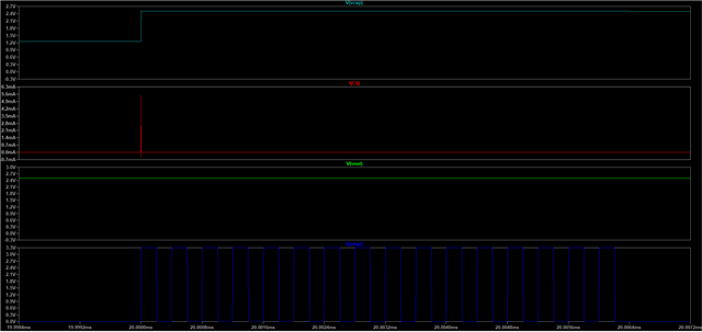

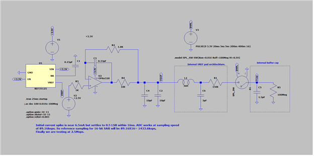

    I have results. Please see below,
    OPA388 reference buffer.
    The buffer reference test circuit has internal parasitic, switch & internal sampling capacitor (1.5pF). Assuming required sampling speed of 89.2ksps, reference has been switched 16 times (due to 16-bit) to 1427ksps per sample & hence approx. 2.5Msps. The settling time seems to be ~15.5ns with initial current spike of 6.5mA. This current spike is similar to what chip mgr. confirmed like in certain scenarios transient could be 5-6mA. Also assuming, output internal 1.5pF capacitor might be going to comparator, it has been terminated by 100Meg. Settling time I am monitoring as difference on VOUT trace just before current transient & after that,  for 0.5 LSB which in this case would be 19uV (1 LSB= ~38.14uV)
    The original circuit proposed by you for OPA388 with CF=1uF, RF=1.5K looks to have some more settling time. With CF=0.33uF and RF=1.8K, settling time is near 15.35ns. All results for your review & comments.
    OPA388 buffer stability
    Both buffer circuit with (CF=1uF, RF=1.5K & CF=0.33uF, RF=1.8K) appears to be stable with PM near 85' but in between PM drops to near 7'. However, transient simulation appears to be stable. I remember there was mention to keep dip near 20' in above thread but as per stability criteria circuit is stable, so is there any comment you would like to add for my reference particularly on PM dip?
    JK

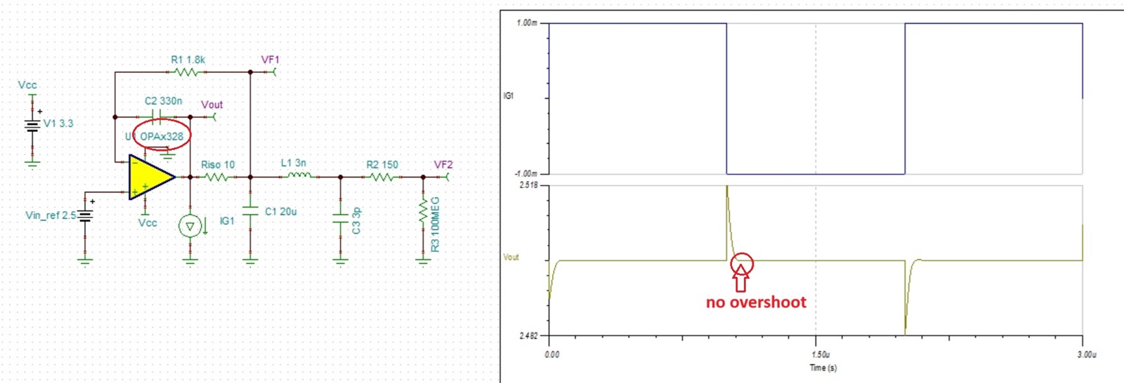

  • The circuit looks pretty stable with no overshoot (see below) so as long as it settles fast enough for your sampling rate I don't see any problem using OPA328.
    OPA328 reference buffer dual feedback (2).TSC
