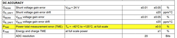

i am looking at the INA229 and it looks like with 20bit ADC and zero drift that the accuracy should be extremely good.
in the DS it is mentioned that there is a 0.5% max across all temperature range.
if i can have this device fixed at 25 degree c then what would be the max error?
