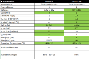

I would like to have price for TS951IDT SO-8
But your system gives me TLV2371DR
Marshal
Thank you for your reply
Yes, do you have equivalent item as TS951iDT SO-8 (8 pins) ?
Hi Marshal,
The TLV2371 would be an excellent replacement for the TS951! The table below shows the key differences between the parts, and as you can see by the green cells, the TLV2371 is an improvement in many ways.
Alex Curtis
