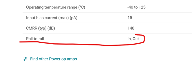

According to datasheet OPA596 is only R-2-R to negative power rail, but not positive.
At the same time elsewhere it's listed as IN/Out R-2-R.
Could you clarify is the datasheet wrong or description is wrong.

Hi Nikolai,
The datasheet is correct and the information on the site you referenced needs to be updated. I will let the team know. It is rail to rail out only.
