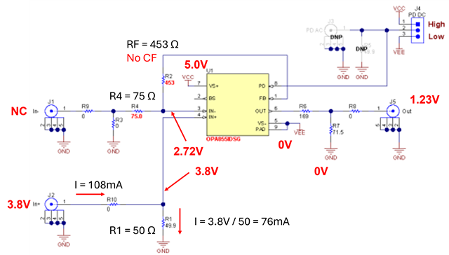

I am testing OPA855DSGEVM as TIA presented in the OPA855 datasheet.
Supply voltages are connected in single-supply mode, VCC is set to 5V positive supply voltage, and VEE and GND are connected together to negative supply voltage from a supply voltage generator.
In+ node is set to 3.8V as shown in Figure-9.1 in OPA855 datasheet and In- is not connected yet.
While supply generator is turned on to supply VCC and In+ node voltages (Vcm), I am seeing large amount of current (~108mA) through In+ node and 28mA at VCC node reading from the supply voltage generator.
Is this 108mA current expected from In- node under these supply voltages?

    I thins the current (108mA) flowing IN+ node is mostly coming from 50 ohm (R1), 3.8V / 50ohm=76mA and +10mA of input current to bipolar type amplifier. Please correct me if I am wrong.

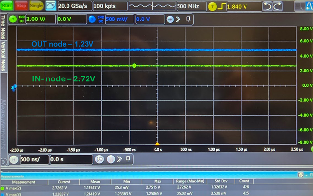

    Here are what I am seeing the voltage waveforms from interested nodes (out, IN-). I don't see any oscillation at the output.
    Are these voltages (IN- and OUT) expected under this condition (Vcc = 5V, Vee=GND=0V)?
  • Hi Doo,
    10mA of current will not go into the IN+ node under normal operation, than max input bias pin from IN+ is <20uA at room temp.
    Your total gain in this case is 7V/V and input is 3.8V. So your device output will try to go to 3.8x7 = 26V. And therefore it will rail to positive supply. Since the supply is 5V and the max output swing it can go is ~0.9V below Vcc (see the VOH of datasheet electrical table) so the output will be clamped at 4.1V. That is why you are seeing 1.23V at the J5 after attenuation from R6 and R7. This will cause the device to go out of the closeloop configuration.
    If you want to test it in TIA configuration, you need to remove R3 and change R4 to 0 ohm, but it that case you have to connect the photodiode also and you might also need to put Cf based on your photodiode capacitance.
    If you just want to test it as a gain amplifier at 3.8V common mode ( at 5V single ended supply) you need to remove R3 and have to give 3.8V at J1 also.
    Anant
