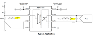

We are currently evaluating AMC1351 as a potential replacement for the Si8931 (Skyworks) for isolated voltage sensing applications.
While reviewing the AMC1351 datasheet and the typical application circuit (see below diagram), we have the following questions:
Q1. Regarding Gain and Output Behavior of AMC1351

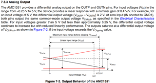

Although the datasheet states that the gain of AMC1351 is 0.4 V/V, the example below shows that an input of 0–5V at the IN pin results in a 2V differential output (OUTP – OUTN).
This seems inconsistent at first glance, so we would appreciate clarification on the following points:
  • Does the gain of 0.4 V/V refer only to the differential output (OUTP – OUTN)?
  • In this configuration, are OUTP and OUTN always swinging symmetrically around a fixed common-mode voltage (VCMout ≈ 2.5V)?
  • If OUTP − OUTN = 2V when IN = 5V, does this mean OUTP ≈ 3.5V and OUTN ≈ 1.5V?

    The 0.4V/V gain refers to the differential output. I believe section 7.3.3 gives a good overview of the analog output.
    The output will swing around Vcm = 1.44V:
    If IN = 5V, then OUTP-OUTN=2V where:
    OUTP = Vcm + 1V = 2.44V
    OUTN = Vcm - 1V = 0.44V
    --> OUTP-OUTN = 2.44V-0.44V = 2V
