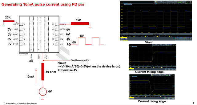

    I apologize fr not replying earlier, there is some technical issue with posting here. I need to apply positive current from the driver to my load, which is a VCSEL. So that would be sourcing current, right? We plan to use the driver in our VCSEL probe station for testing devices.
    While we do need currents lower than 30 mA, we can handle them being less accurate, assuming the pulse is relatively stable.
    If there is anymore information you require, please let me know.
    Nitzan

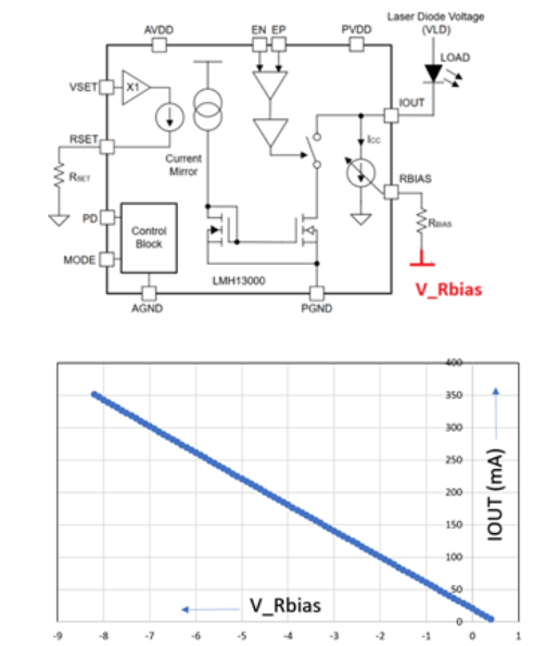

  • Hi Nitzan,
    Sorry for delay in response. The LMH13000 cannot source current it can only sink current. If that is ok, it can be done using RBIAS pin. LMH13000 cannot set current of 1mA from VSET pin, but we can do it in two other ways if the pulse frequency/rise is not very fast like in your use case
    1. setting the current using the RBIAS and pulsing it by enabling and disabling it using PD pin as explaing be Shreenidhi in the previous comment
    2.Using RBIAS resistor and giving pulse input at V_Rbias (other side of the RBIAS pin) as show below
     here Rbisa=5K
    Anant
