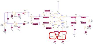

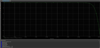

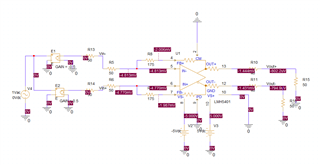

I performed an AC simulation of a circuit in PSpice for TI, and the gain was only 17 dB. However, according to theoretical calculations, the gain should be Gain=(175+25)/50=4. What could be the reasons for this discrepancy?

Which nodes are you using to compute the gain based on above schematic?
I see issue with supply voltages. LMH5401 supports 5.5V supply max.
